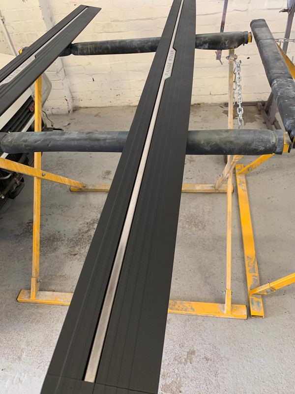

I decided to do mine myself they are very easy to remove all old paint was removed at the paint shop steps were masked up and sprayed now looking like new again as were looking really scruffy and mine is out of warranty....

Post #601088 Wed Jul 01 2020 7:39am
Hi Martyn what paint did you use to refurb your side steps? How did you strip the old off? Have they lasted ok?
Cheers,
Pete. L494 3.0L SDV6 Autobiography in Chile Red (Current)
L320 3.0L SDV6 Autobiography in Baltic Blue (RIP 29/03/2021 insurance total loss)
Post #612055 Mon Mar 29 2021 7:57am
RRSporter
Member Since: 08 Nov 2012
Location: UK
Posts: 61
Martyn wrote:
Hi Pete
Resurrecting and old thread here. I had drivers side repainted at body shop in anti slip truck bed type paint.
I’m afraid 18 months later lots has worn off.
I’m a little unsure how to proceed. My may did use some alloy etcher first as well to try to make the coating adhere.
Has anybody found a long lasting way or refurbishing them? Powder coating perhaps 🤷‍♂️? 3.0 SDV6 HSE L494
