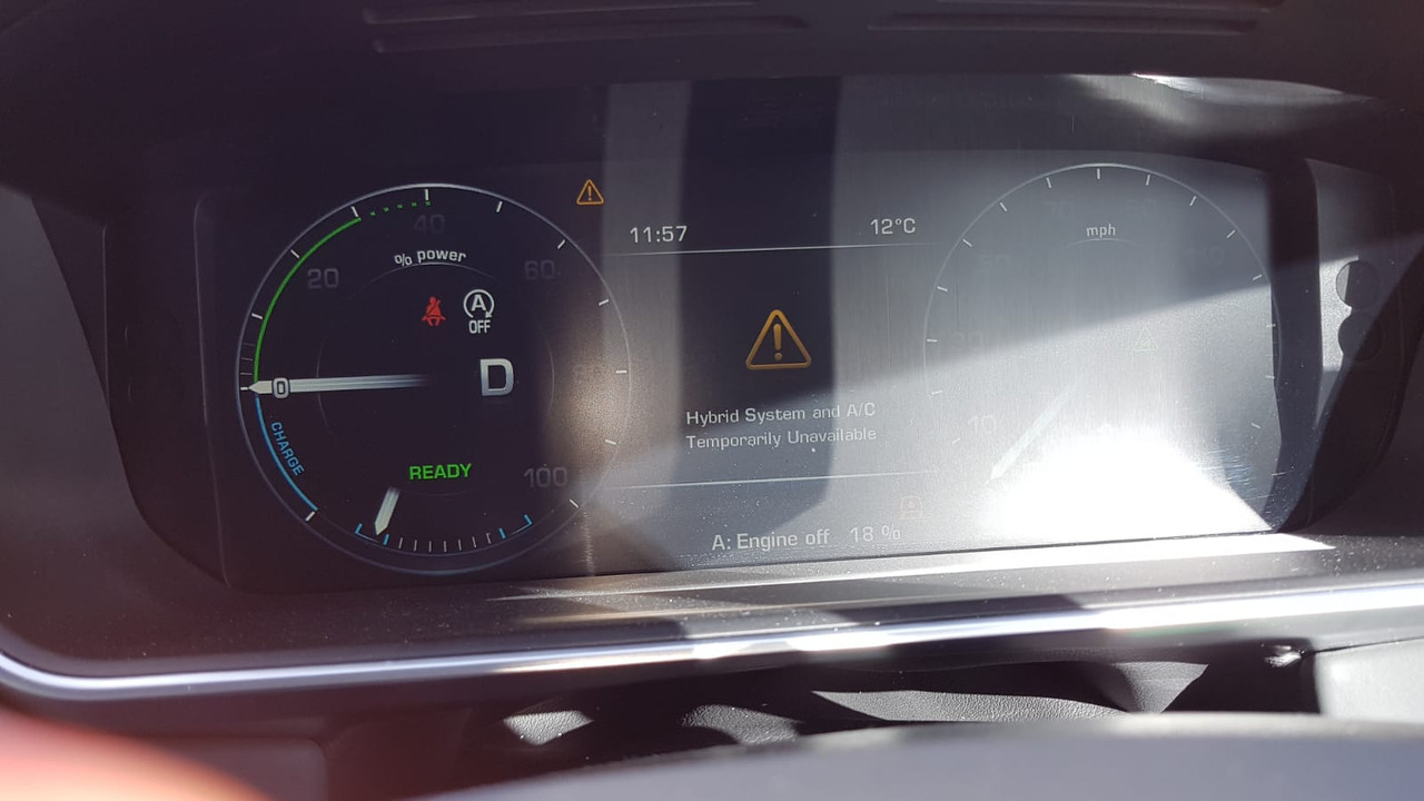

Hi Guys.
Sun Apr 07 2019 1:11am |
Tim in Scotland Member Since: 30 May 2005 Location: Driving along in my automobile Posts: 17476 |
If you had the HV battery nearly discharged and also had the climate running and audio on then the ECU for the HEV will drop all the heavy consumers in use to have enough EV charge before switching you back to diesel power. I had a similar thing happen in my Countryman PHEV yesterday and on investigation I had almost run the HV battery to 1 mile range but was also running the climate control and the audio system (I have the top model Harmon Kardon Logic 7 sound system in the Mini and the amps are big power consumers).

thomas brown Member Since: 29 Mar 2016 Location: Norwich Posts: 559 |
Hi Tim.
Wed Apr 10 2019 4:54pm |
Hi Guys.
Fri Apr 12 2019 9:48am |
Glad it was all solved quickly and easily. Now that JLR is concentrating more and more on light hybrid systems and PHEVs hopefully they will also properly train more technicians to deal with the special issues these motive systems can have. The dealership I bought the Countryman from has one specialist salesman but NO specially trained techs and they sell BMW electric vehicles as well as Mini PHEV and they will also be dealing in the forthcoming Mini BEV, they have ONE specialist technician shared between 4 servicing centres............. now it isn’t waiting for a courtesy car to become available, it’s waiting for the availability of the electrified vehicle specialist to be available!
