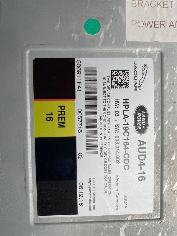

I have a 2017 RRS Autobiography with the Meridian system. I want to locate the subwoofer and believed it was located under the front seat (drivers side in UK), however upon lifting seat up the amplifier is under there (the amp is Prem16 with a code as per image below). I checked the other side hoping it was there and its not??! I have another module that side which looks like the FM/DAB/TV receiver. Any ideas? I know there are bass speakers in the doors. Images attached....
First image is under drivers side:

Well I spoke to Land Rover who sent me the audio layout and diagram and my sub is actually in the boot right at the back near the battery. Although mine is a late Dec 2016 it fell into the MY2017 so has the later Meridian setup rather than all the clips on youtube which are the earlier ones!
Now to get wiring my LOC in and install my sub!

Here is the layout they sent me and I have checked every speaker and they are all there on mine, not just the grills!
Tapped into the sub wires just the other side of the plug that the sub connects to (same colours as the pre-2017), plugged into my LOC, gave the LOC power/ground and RCA leads from the LOC to the Rockford Fosgate amp and off it goes, works perfectly! Very pleased!
